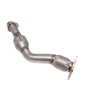

Carboned up intake valves, broken flex pipe, come to mind the flex pipe should cause a code. The fuel system cleaner , was that for DI engines, you mentioned spark plugs AC Delco’s? Or some other brand?

So still planning on getting on mechanic’s lift to check exhaust/flex pipe. Though they’re confident they would have gone over that already.

or it could still be exhaust as motor would blow harder during acceleration too

I don't think SS has a flex pipe.
