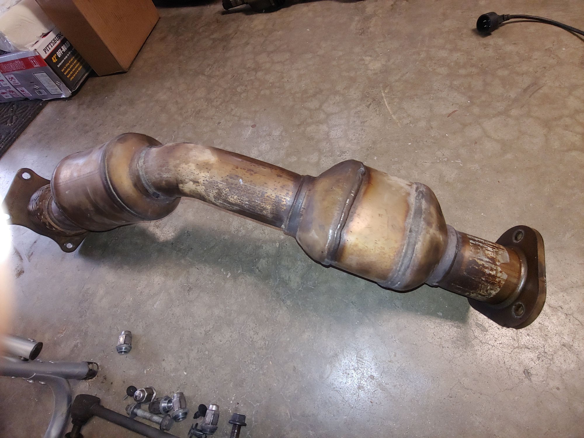

SS comes with a flex pipe. Hard to see it, on the left.

It’s just not the accordion flex pipe like the 2.2 or 2.4 has.
In the picture above that flex joint is called a bellows.
The one that looks like a "Chinese finger" is a flex coupling.
Yes the bellows style is more prone to crack than the other one.

These are not from an SS , Left one is a flex , right one is a bellows I believe the SS came with the flex and not a bellows

Yes, SS is like the one on the left.

Actually that’s the one from my 2.2 with the mandrel bends. But I know what you mean the Chinese finger mesh looking one.
