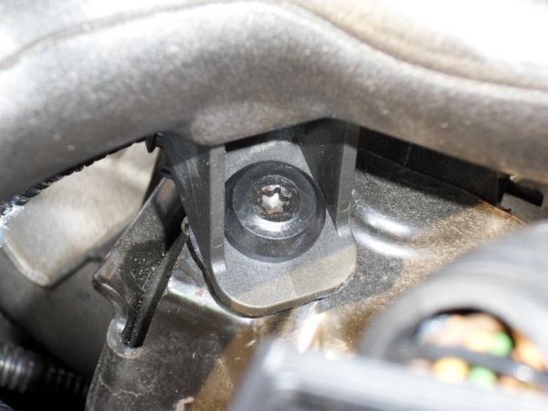

Most recently, I found the hot side pipe bracket flopping around on the mounting post with the grommet crammed inside the bracket area since, I'm guessing, the dealer fixed was working on a finally fixed the boost problem I have last year (three trips to the dealer before mechanic found a loose connection at the intercooler). Anyway, I installed the grommet correctly (I think) and now the pipe doesn't move around. Could it be that the loose pipe movement cause a momentary leak at the joint(s) enough to throw a pending code? I don't know, but I'm hoping for the best. Only time will tell...
