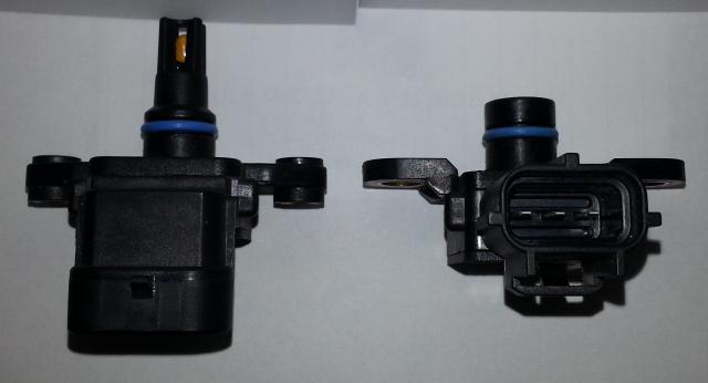

Don't use any type sealer. If you're worried about having a leak, then you should replace the O-ring with a new one. A light coat of clean engine oil on the O-ring is what's recommended by GM when installing the Tmap sensor.
Here's a picture of both the upper and lower stock Tmap sensors. The O-rings(in blue) should be available thru your dealer. They will be the same size for the Bosch sensors used with the GMTU.

The bosch 3 bar only have one screw hole to secure them
Old Sep 22, 2014 | 06:59 PM
Posts: 11,721
One does. The other has both screws.
