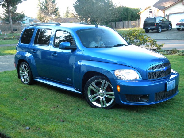

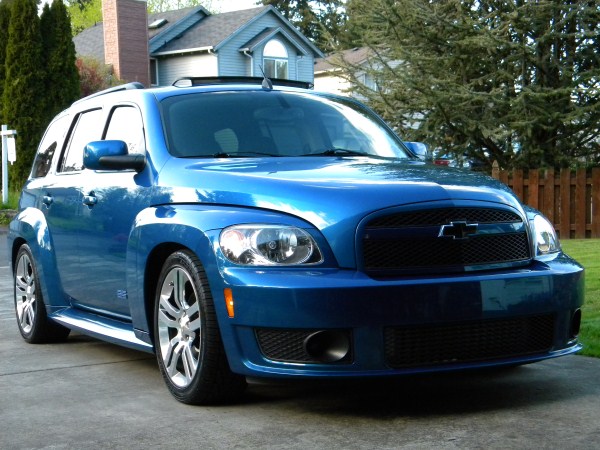

before after and after

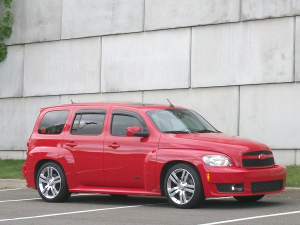

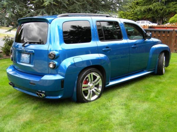

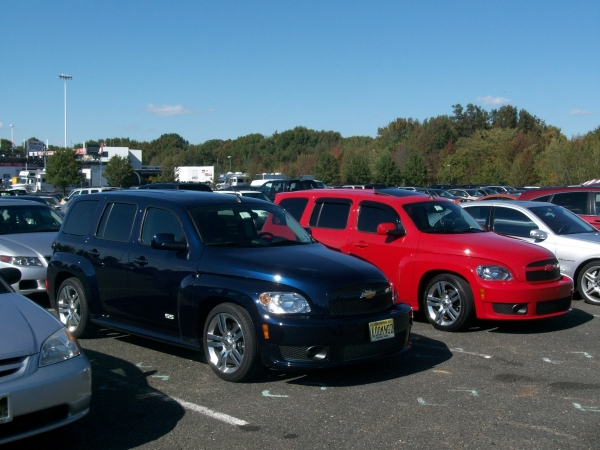

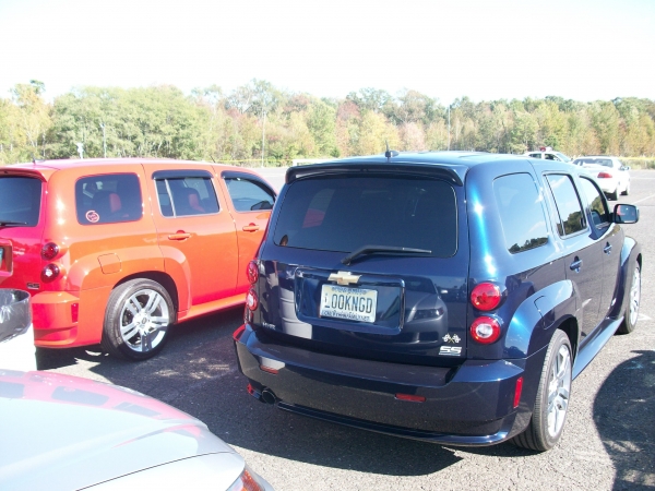

Here's some recent pictures. I Daily Drive mine even in the winter and never had any problems to date. They've been on for just about a year now and have settled nicely IMO.
When first installed:
These were taken about two weeks ago when I had the new rims installed:
This one was taken Saturday:
and to compare at stock height:
and sitting next to Rodney B (stock springs, but I was still about 1" lower than his, weird):
