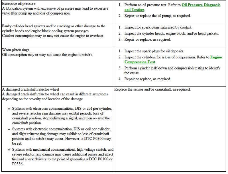

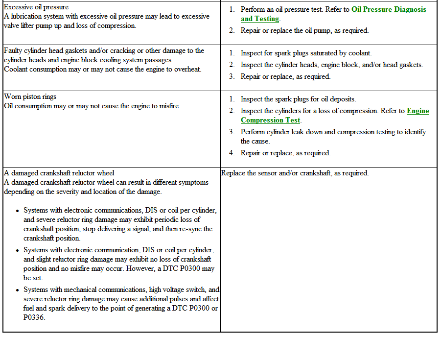

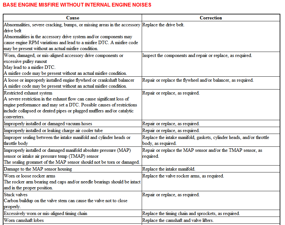

From Mitchell OnDemand:

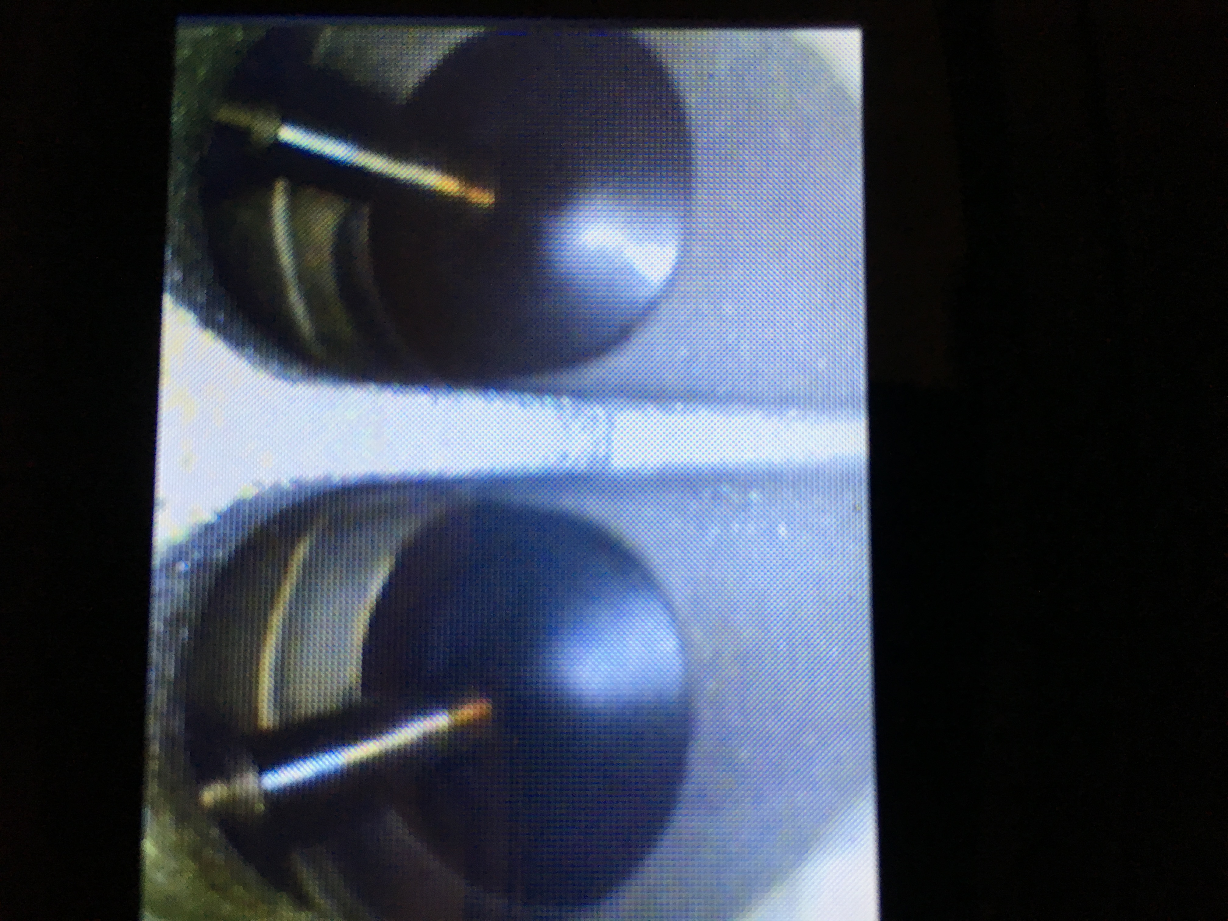

For what is it worth you might try to inject some water in the intake so it will get into all the cylinders. Water is a good cleaner for the intake valves and cylinder. It will remove carbon buildup. I have water injection on mine so it gets water under boost all the time. It wont make difference if you are direct injected or port injected. Fuel will not wash off carbon from valves. If any thing fuel will leave deposits on intake valves. If you install a water injection system you can clean you intake valves and cylinders at will. There are other benefits you get also.
Here is a pic of my intake valves at 226K miles.
Attached Thumbnails Misfire on 3. Head tear down video hhr ecotech turbo-img_1828.jpg

yes a good idea. i was thinking a 5th injector, fuel instead of water to wash the valves.
i have hptuner so easily done. can't deny the use of water, very clean.

Like I said . Gas is not a solvent. It has too many additives in it and you will still have deposits. Try this take a pan put 8oz of fuel in it and heat it. You will find a lot of sticky left overs from the fuel after it boils off.
Water is still the better way to go.
