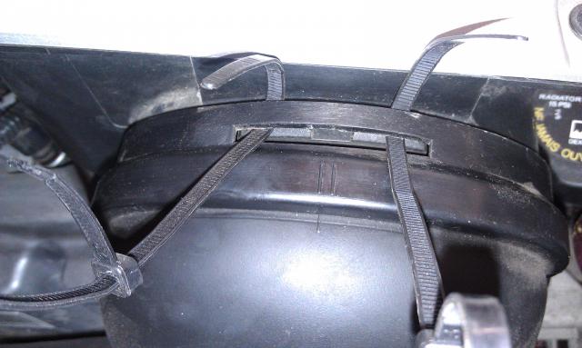

I am assuming some may have the stock flexible air inlet tube from the Fender to the air cleaner.
I found out yesterday that it can be a bit tough at least on mine to get that off with out making a mess out of the plastic
Here is a quick and easy way I found to get the tube off two zip ties and then pull up

Also I found that when installing the tube its easier to put the tube on the air filter box first bottom first then top then attach to fender.
