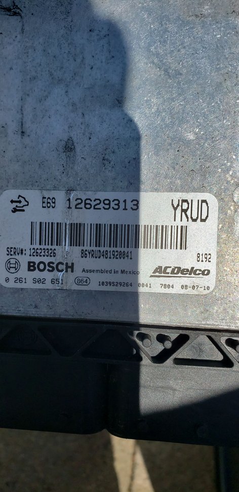

Anyone know if bosch is the factory computer? Or is it aftermarket?

Well it does have the ACDelco logo. Which computer?
this is the computer on driver side by fuse box.

I'm thinking you have a manual transmission, so that would be the ECM. Here is a picture of mine.

Well that looks like i have the factory one then. Thank you rj. Gonna look into tunes if I can't figure anything else out soon or take to dealer. Gonna try smoke machine tonight incase I missed a leak somewhere
