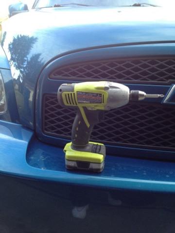

Vince will make it go zoom, you need one of these, 12v lithium impact, this little sucker will back the luggs off if you want. Zip, zip lids off.
