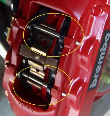

After many hours (over several attempts) fighting with the stupid pins in my Brembo calipers, I've decide to replace the calipers. Not only are the pins completely seized (PB Blast, MAP gas heat, 3lb hammer...no luck), but at least one caliper looks like it needs a rebuild anyway.

Cut the pins down the middle then cut them as short as you can on each side. Then heat a hammer and a punch. This way your breaking one pin at a time loose.

BTW, in addition to PB blast and heat, my buddy held the punch with vice grips while I swung the three pound hammer. Completely flattened over one of the pins, flush to the caliper. The thing never budged. There's no way you should ever have to apply that sort of force to the vehicle for a simple repair like replacing brake pads. In my book, this qualifies as a really stupid design. In this case, on Brembo's part rather than GM's.

Donbrew. He's referring to the pins that hold the pads in place. He did not go without front brakes.
