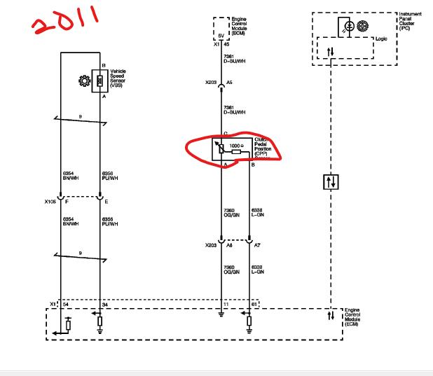

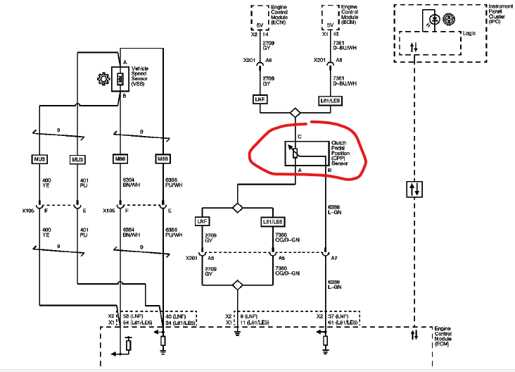

I don't know if this has anything to do with it, but in looking at the electronic diagrams for the manual transmission: in the 2011 M86 (LS/LT) it shows a 1K resistor in the clutch pedal sensor. There is no such resistor in the 2009 diagrams. I wonder if the parts books a wrong again?
That's very interesting! I'd assume, from viewing those diagrams, that the 1k resistor is in the switch itself. But according to GM Parts Direct's online parts catalog, a 2009 HHR and a 2011 HHR use the same clutch pedal position sensor.
