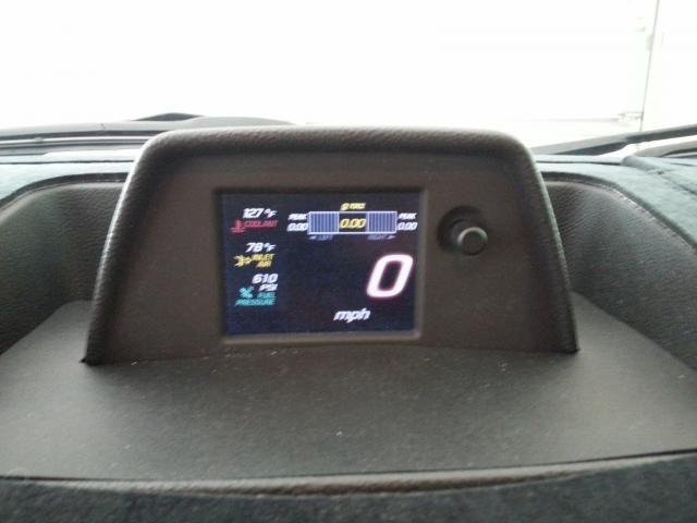

Hey guys im sorry, I searched this and had no luck... My RPD just stopped working all together tonight.. im worried i buggered something up good.... Is there a fuse for it?? I looked and cant find one for it under both the hood and passenger side fuse box. I have no display on it whatsoever.. just a black screen no power to it at all

I think the cig lighter fuse #29 under hood is the correct one.

Old Aug 7, 2019 | 09:19 AM
Posts: 40,083
One of these

What’s on your dashboard? A cubby like the LS/LT models?
I’ve only seen the RPD on the SS dash .

Yes, a cubby. It was an option in '09, standard in '10. So '08s didn't get it, some(probably most) '09s(like mine) didn't get it.

I have an 09' SS Panel with the RPD. Dumb me wanted to put an Apillar Boost guage on and i hard wired a boost guage from a Cobalt in and i was a dumbass and idinr tapenup the wires ans i shorted out one of the 4 wires that was used the dimmer and blew the dimmer fuse that controls tail lights, dash dimming, and radio lights but the radio lights being out is just becuz its a warning that there is a problem with the tail lights or a running light bilb and allcof them were out.. i fixed the one of the fuses thats under the hood that was for tail lights i believe and all the lights worked as they should but my RPD doesnt work and neither does my DIC...thats why i said i think i buggered something up..... I know.. the moral is tape up wires even if you just wanted to aee something work for a second.. i dont even have the Apillar trim... I just wanted to a ee ifnit worked....like a little kid.
Old Aug 7, 2019 | 01:42 PM
Posts: 11,721
Uh Oh. So you were wiring up a boost gauge and shorted something.
Guess it's too late to tell you that the SS is pre-wired for the A pillar boost gauge. The wire plug is behind the blank pillar trim on the RPD equipped models.
All you needed was the A pillar trim piece w/booster gauge. It would be plug in and work in tandem with the RPD.
And FYI. There is a boost gauge on the RPD.
