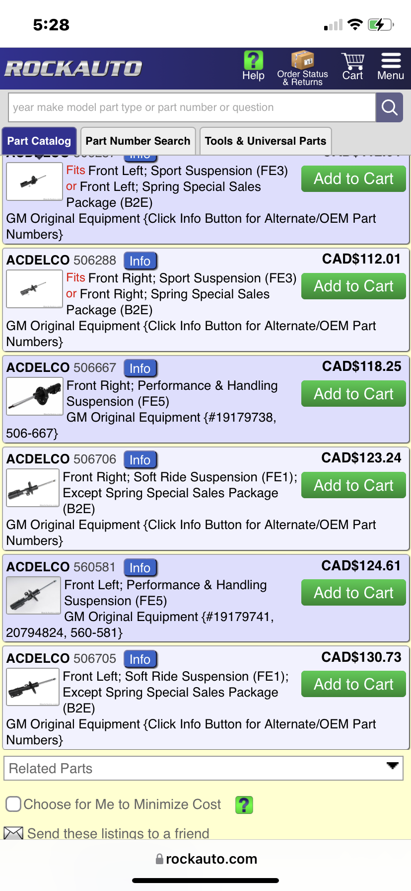

I'm putting together a package at Rock Auto. This is what I've got in it so far. Anything else I should add to it? My car is an '08 but it's only got 100,000 Km (~60,000 miles) on it.
Struts: OEM AC Delco FE5 struts (RockAuto charges ~$120 CAD each for them. The GM Stealership I called here in town wanted to charge me $300 CAD EACH for them )

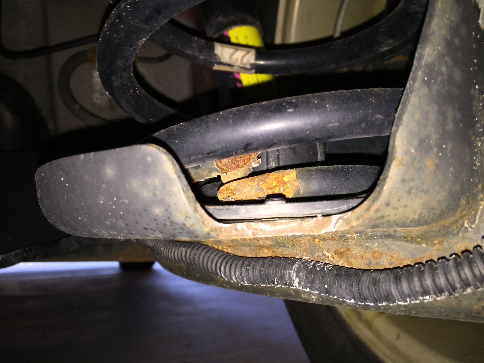

You might look for a broken rear spring, they seem to break at the bottom.

Sometimes the break is hidden

These FE5 struts from AC Delco

@Oldblue , those Energy Suspension PU sway bar bushings come with their own brackets. Are you telling me the ones they come with are too small or did you mean the OEM sway bar bushing brackets won't work with those bushings? And yes, I chose the FE5 struts from AC Delco.
