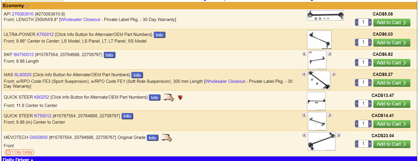

While Mevotech does offer a cheaper "Original Grade" sway bar link that Rock Auto sells in its Economy offerings (see screen grabs below), the Mevotech Supreme line MS50800 that I am looking at is not cheaper than any of the links that Rock Auto has on its Daily Driver offerings list other than the OEM GM and AC Delco Gold products. It is only one of two of the products on the Daily Driver list for the HHR that is greaseable which means it's only one of two that don't have a plastic ball joint cup and of the two greaseable ones (the Moog 9.86" one being the other), it is the only one that advertises that it has a sintered metal bearing cup which would make it superior to the Moog if the Moog doesn't also have a sintered metal bearing cup. The Moogs might also have a sintered metal bearing cups but you can't tell if they do or not because they don't say.
