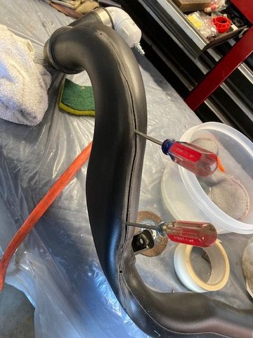

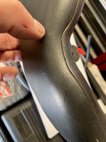

The symptoms were - no boost immediately after boosting for a few seconds. You could drive it mildly but any big throttle caused it to buck and eventually threw a P0101. I have a spare set of both boost solenoids and a MAF. Tossed them in, no change. Did the leak test and the pipe split along the seams with another crack going up over the top. You couldn't hear the leak though. On my Duramax, it was a trumpet but on this LNF, nothing.

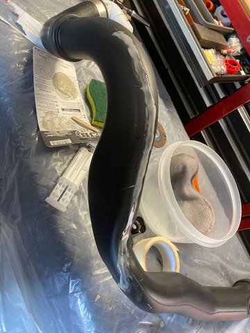

Edit2: I rescaled the pic and added one showing the length of the crack and another showing the fix. While I wait for the new one, I decided to try and repair this one. I drilled holes at the ends of the cracks and then held it open a bit to allow the epoxy to flow in. I'll pressure test it again to confirm and then install it. It's just temporary but I was curious if JB Weld. Plastic Bonder would hold up.

Initial crack I found
The actual length of the crack held open with screwdrivers.
JB Weld Plastic Bonder applied.

Edit2: I suspect the JB Weld won't adhere well enough to the plastic. It's curing right now and is certainly rock hard but I am suspicious. If it doesn't then I might break out my plastic welder and see how that goes.
Edit3: Yup, few things will work with PA66-GF25 Nylon ...
It appears the pipe has been split slightly for a period of time along the seam and with expansion and contraction a crack started outside the seam eventually traveling to the center of the pipe. It finally opened enough to pretty much kill all of the boost. In hindsight, I have watched the boost go to 22 or so (depending on a lot of factors) and then sag off a couple of pounds. I'll be curious if that goes away with the new pipe.

To PulpFriction and Old Blue - After messing with various solutions I think the only viable one is a nylon solvent and patch applied to the inside of the pipe which would be nearly impossible to achieve. Many things will stick to Nylon but few will stick well enough to hold 25PSI of pressure.Anything on the outside would just flex under boost and leak. The Flex Seal tape might get you by to get you home as Old Blue suggested though! My crack was long but in a section you could easily wrap on the side of the road. Don't tempt fate with a lot of boosting. You'll lose.
