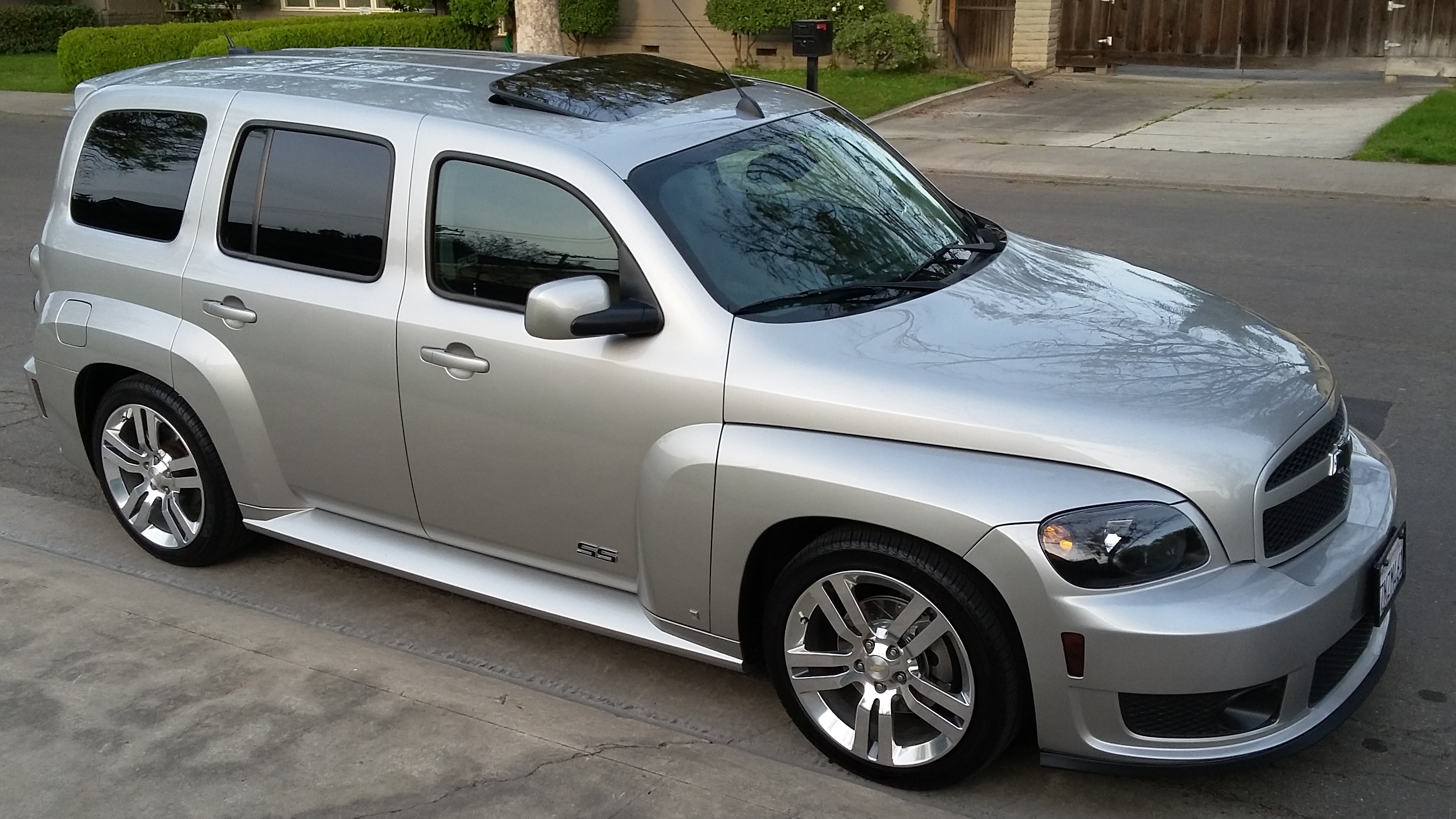

wow, I just uploaded these pics of my HHR and wow people really hate HHR's, some not so nice comments, lol HHR SS
No offense, but posting up 340 hp on a car that's only rated at 260 hp. Yeah, that could get you some negative comments.
I guess I should have clarified that 340 is a guesstimate with my mods/bolt ons.
