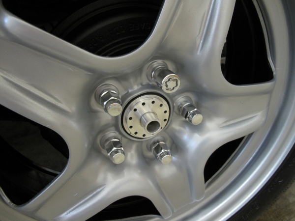

Here's how I mounted the base on the front:

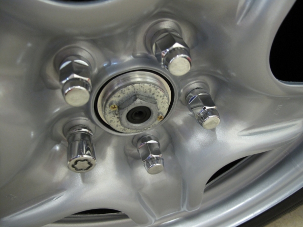

The rear:

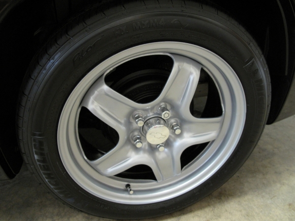

And what they look like mounted:
Requires drilling & tapping rear hub center, and cutting/fitting/drilling of breather base parts to work. Also need a front axle retaining nut cut in half to attach to fronts. The star shaped piece surrounding the center in the pic of post #4 is a Caddy Catera (same 5x110 bolt pattern) wheel centercap with the center cut out of it...looks good surrounding the center, but couldn't really find a sanitary way of mounting them, so I'm not running them...for now
