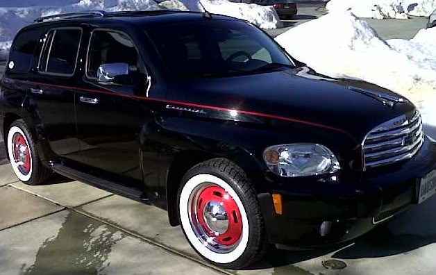

Or 225/60 16's from Coker but they show they are 26.60 inches tall
https://www.cokertire.com/bf-goodric...whitewall.html
But look very cool!
Those are 215/60-16's per
https://www.chevyhhr.net/forums/tire...our-hhr-27740/
From Diamondback, check page 21 of 44, here for 215/55R16's
http://www.dbtires.com/2015_catalog/2015_Catalog_Hi.pdf

Isn't 26.20 the tallest we can go?

On page #21, the 215/55R16 shows 25.2 inches tall just like the factory wanted!
