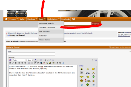

I have not checked the "tire rim calculator" located in the TOOLS menu on the menu bar or the one posted previously in this thread. But, I don't think so. Mainly because the width, the stock wheel is 6.5 if you go 5.0 a 245X45 is too wide.

There is a tire rim calculator in the tool bar click on tools
