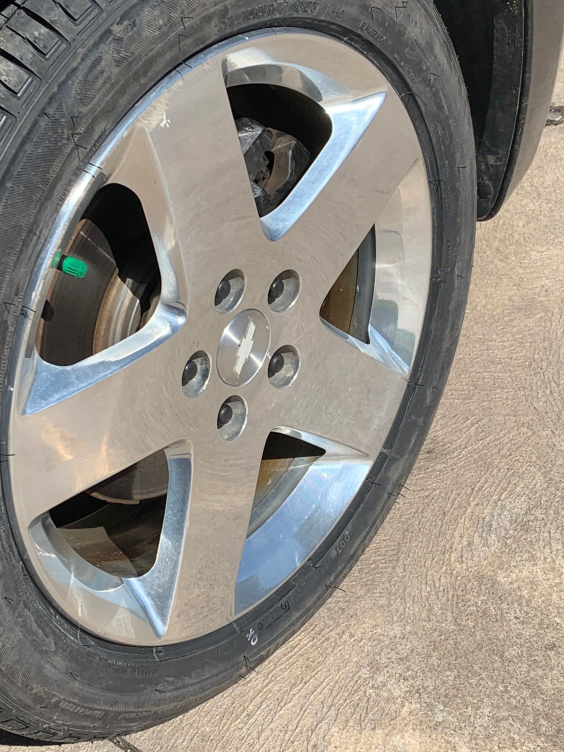

And these photos are of the re-finished rims...
Spiffy, sparkly and polished!
They look great from 10 feet, even better at 70 mph! Perhaps I’m just to picky , but I’m happy with the results.

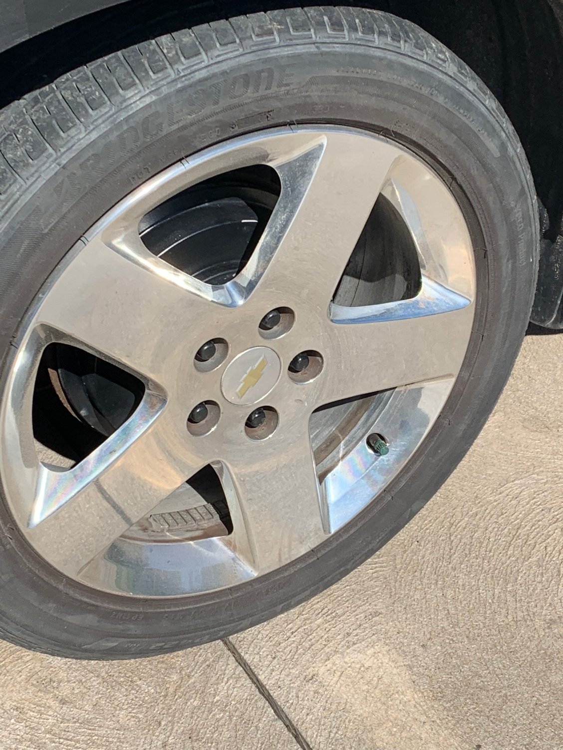

Is there any hope for this wheel? It's shiny where the clear coat has completely come off.
Old Jan 1, 2022 | 03:33 PM
  #37
Posts: 40,083
Sure , either sand or chemical paint strip the clear off, then sand and buff then polish, you can either polish them after that or clear them .
These are my next set of 17” 2LT aluminium rims.
One has some curb rash
But from this distance, they look good, and at 60 MPH they look awesome, so you don’t have to go overboard buffing and compounding and polishing.
