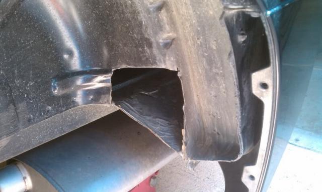

Sorry, I don't want to hijack your thread but if you want the largest rear tires that will work, here is how to do it. These are pics from a post I did on 7/27/10

No that's cool Lasater, but I don't want to cut things up. I also don't think running 17's with a .5 inch width difference will create a rub issue on the rear, although I will want the side profile of tires to be the same or as close to a little more then the front.

Best to stick with the same size rims and just get some tires that are 26.3" or shorter. The 26.3" is about the max before you run into rubbing issues with the lower strut perch.
Thanks for the maximum clearance numbers Fireman and upon closer inspection of the photo lasater posted it is the rear well cut. I'm still working on the offset and backseat of the rims. The more I ponder it looks like keeping the 16" tires I have and mounting on the same size rim may be the best sensible thing to do. Just installed running boards I pulled off a Daytona blue wreck for $40. Nice upgrade. Had them painted to match my black panel. I think Catera rims would look nice reconditioned and painted black chrome or anthracite silver. I'm not big on the black on black rims and it seems to be the thing everyone here in Florida is doing. It makes the appearance to me flat looking and now to common.

Well then if you don't have them, you are golden. I'm running the largest rear tire I could fit. Rears are 225/60/17. You have to cut out some sheet metal in the rear wheel well area and modify the plastic wheel well liner but the results are worth the effort.
Do a search on my previous posts and you will see how I did it. With the right springs (I used Eibach) and spacers (I made some from 3/4" aluminum) it fills the rear wheel wells perfectly.
Good luck. This is a mod that really makes a big difference in the way the car looks.
