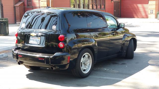

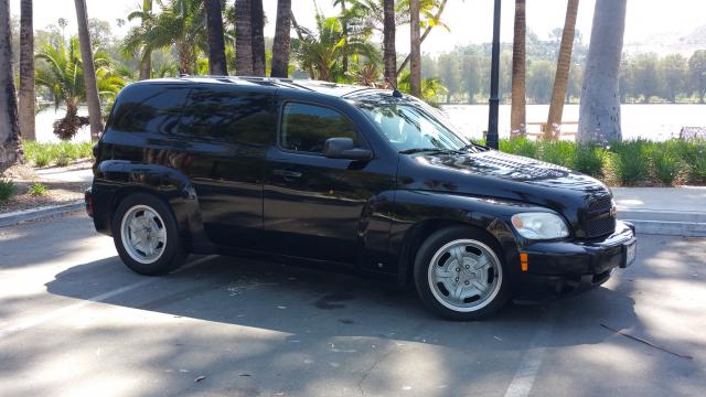

IF........and that's a big IF you don't have ABS brakes and traction control it will work fine. My '08 panel has had different sized tires front and rear for 125,000 miles with no problems. In my humble opinion the most glaring shortcoming of the HHR is the large rear wheel openings and the tiny stock rubber the cars come with.

Well then if you don't have them, you are golden. I'm running the largest rear tire I could fit. Rears are 225/60/17. You have to cut out some sheet metal in the rear wheel well area and modify the plastic wheel well liner but the results are worth the effort.
Do a search on my previous posts and you will see how I did it. With the right springs (I used Eibach) and spacers (I made some from 3/4" aluminum) it fills the rear wheel wells perfectly.
Good luck. This is a mod that really makes a big difference in the way the car looks.
