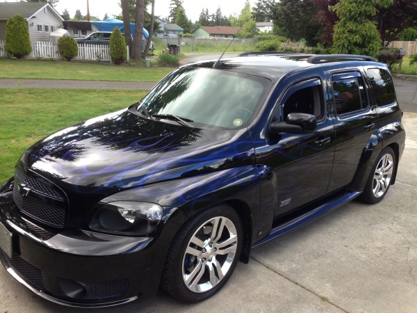

They drive sweet in all conditions and have a 45K rating. looks like this.
I have had 9 or so tire changes on these, and have noticed major differences from tire to tire and manufacture. The tires I know for a fact that fit in the 235x45 size (with out coilovers) on a 7.5" rim are Michilin pilot sports. I plan to buy a set when my gmax finally wear out.
http://www.tirerack.com/tires/tires....omCompare1=yes
