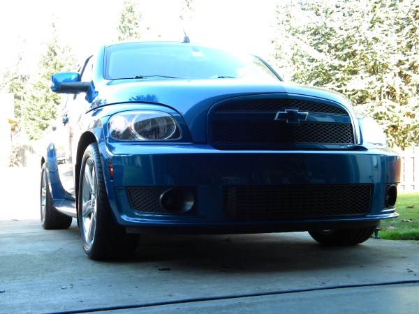

I have 255x40x18's, G-max03 on mine, but I have 8" wheels. I have put a set of Michelin Pilot sports in 235x45x18 on stock SS wheels.

looks cool! def need to know regarding stock rims though.

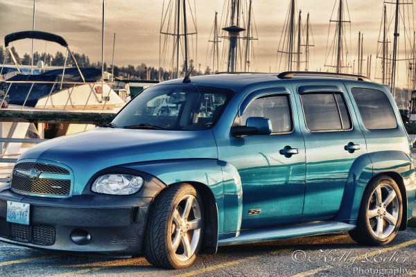

Looks better if you lover it on KWv2's.
Old Nov 26, 2012 | 10:37 PM
skyline26's Avatar
Joined: 08-09-2012
Posts: 1,979
that pic is awesome!
