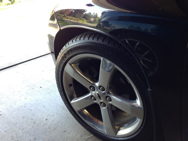

SS FAN, I would like to put tires on my SS that have more rubber between the wheel and the road. What size would I need to buy. Thanks.
Boydie
Originally Posted by SS fan
The second part,..... I have put a set of Michelin Pilot sports in 235x45x18 on stock SS wheels. He loves them, they look good.
Old Aug 7, 2014 | 08:52 AM
Sorry Boydie, I didn't see your question. The answer is there....235x45x18 ....I now have them on both truckletts. They ride a little softer. I went with the Michelin all season.
Old Sep 4, 2014 | 12:11 AM
Bigpatshhr's Avatar
Joined: 09-11-2013
Posts: 143
From: Louisiana
I just put a set of 245-40/18 on mine with stock ss wheels and stock height. Little tight on rear plastics but passes all the way and has plenty of room on the strut perch in front.
