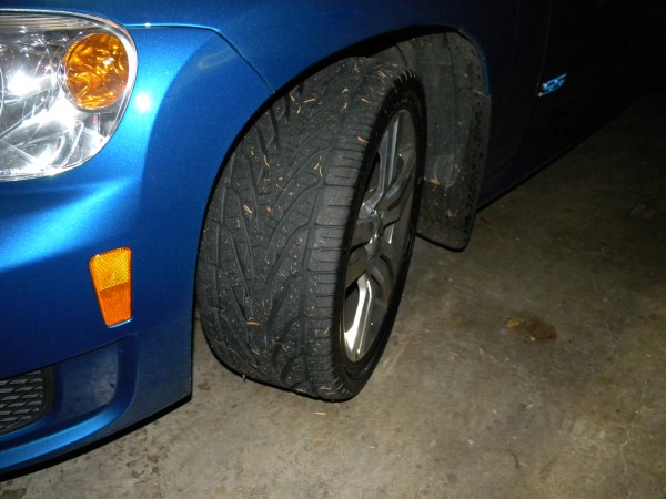

I put Firestone Winter Force tires on the wife's 06, the tire dealer put 40 lbs of air in them, this seams like a lot of pressure.
Is any one else using this tire? And what pres are U using?
I lowerd them to 32lbs, but haven't had a chance to drive it and see how it feels.

Boy, 40psi is way too much. Regardless of whether you are dealing with a winter tire, summer tire, or performance tire, you should always use the tire pressure specified by Chevrolet. Running the tires at 40psi is over inflating them, that will actually give you less traction since the full width of the tread is not in contact with the road. You do lose pressure in cold weather, but this is regained from the heat generated during operation, this will bring the tires up to normal pressure. The tire pressure specified by Chevy takes all of this into account, you might not believe it sometimes, but they do know what they're doing.
I find mine fluctuate between 32-38 so I try and air them up for 35+ Any less and cold temps start to drop them to 27ish. When they're that low, they lose even more air.
40 is too high, you'll wear the center of the tire out awfully fast and have less traction overall.

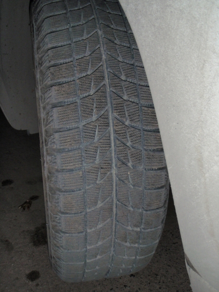

My winter tires - Bridgestone Blizzak. Here they are.
Just like you, I bought a tire diameter of 60. The volume of air gets to go a little bit more, but the pressure I support this, as described yesterday.
Incidentally, the pressure drop in temperature. If the wheel tires inflated with air, the pressure is strongly dependent on temperature and the temperature of the tires. Several times I got into a stupid situation when, after 300 km mad race between the cities I've been getting the following morning deflated wheels.
To prevent this from happening - pumped nitrogen into the wheel. Nitrogen does not change its volume in the normal range of temperatures. In Russia, this service is widespread and is not expensive. I have no doubt that in the U.S. that too much.
