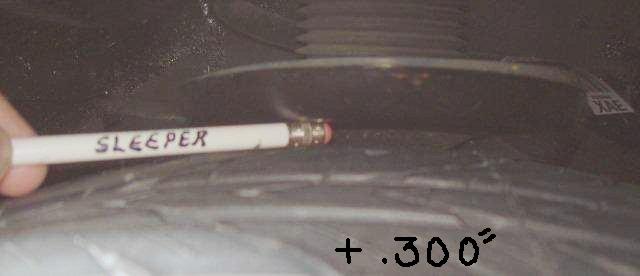

Wheel height max of 26 inches before the strut perch becomes an issue.
Old Mar 8, 2012 | 12:31 AM
Agreed, here's a shot of the clearance on mine with 26.1" tall 225's.. this is Maxed out imo..
