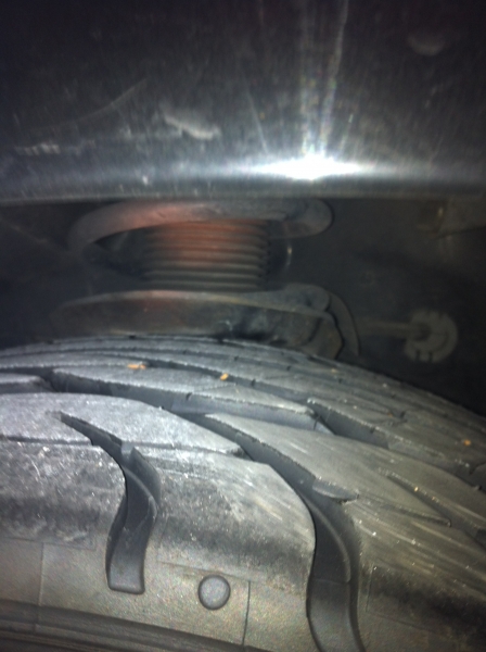

This is what the front looks like straight. If you put your hand on top of the tire and move back toward the springs, you can feel that the tire is pressed against it. Obviously that can't be good for anything involved.

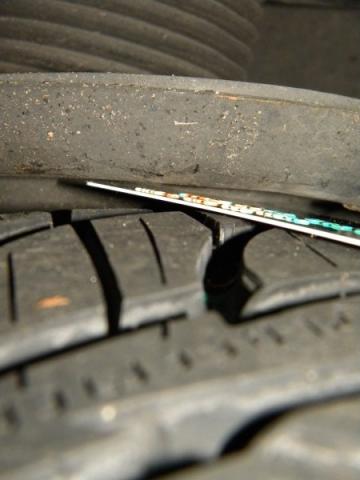

looks a little tight, I have lots or room, the swollen and bruised card I used to pay for them fits. they are 255x40
Discount tire actually will let you trade them in with in 30 days if you don't like them.245x45 are 8mm taller than mine. No way, surprised they could wedge them in there, and roll too.
That makes me feel a little better. And yeah, I am really stumped at how they could look at it in daylight, see that the tire is actually riding against the suspension (the part that your credit card is almost touching) and say it's OK. Argh.

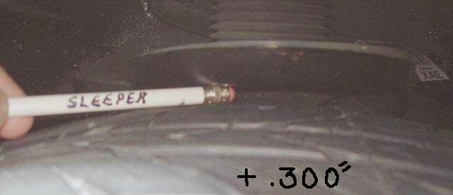

I'm running 225s' (17's) that are 26.1 tall & just fit.. have .300 clearance to strut plate..
Note: When on the rack & wheels are hanging, the clearance does increase slightly.. (this may be where the tech thought you were fine)...
It's only when full weight is back on the ground & bounce it a couple times do you see exactly what clearance ya got..

How dangerous is it to have the wheel pressed up against the strut plate while driving? It's about a 7 mile drive to get back to the shop. In the ~10 miles I've driven it so far, I haven't noticed anything wrong performance-wise, and hit speeds over 70mph. Obviously I'm going to slow it down, but still it seems to me that it's a pretty bad thing to have happening, no?
This is where you have to be at attention & check yourself.. I am permitted in the local shop when I get tires done, so I'm right there.. Not many places allow this.
I would be careful going back, it has to create heat in the tires scrubbing the strut plates in front.
Take yer time. & check before you leave the shop this next time.. & You should be fine.
I carry a LED pencil light.. So I can see good in the dark areas. fwiw.
Edit: I would not drive any unless it is just back to the tire shop.. Get too much damage on those tries scrubbing & they may NOT take them back...Remember you wanted that size..
It is Not a recommended fit..
