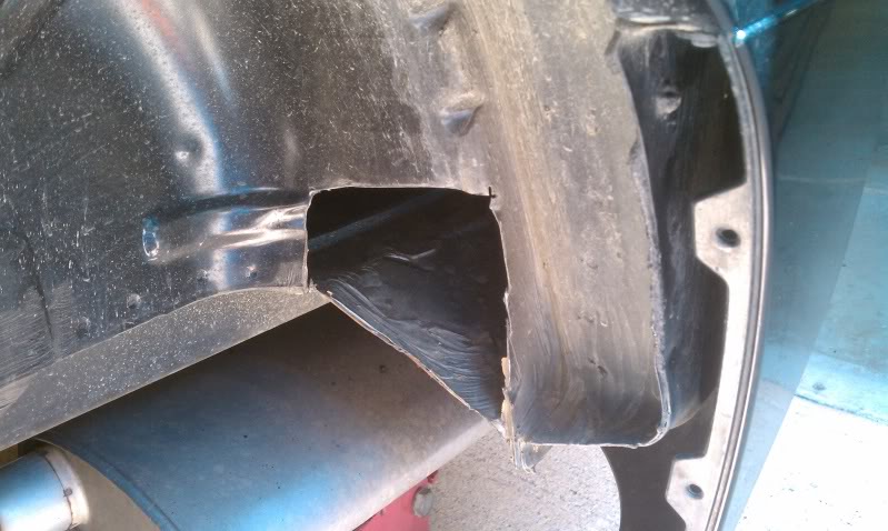

The trick came by cutting the rear "box" area out of the rear wheel wells. I went to my local Chevy dealer and asked them what was inside these areas. The pulled it up on the computer and they are empty....no apparent reason for them. So I removed the the plastic inner fender panels and took a cut-off tool and removed the area that stood out.

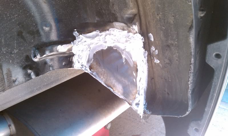

Then I fabricated a 19 ga. patch and welded it in. (watch your heat here, the factory caulking will catch on fire from the heat. This is NOT where you want to start a fire) After it cooled I took some silicone an caulked the area.

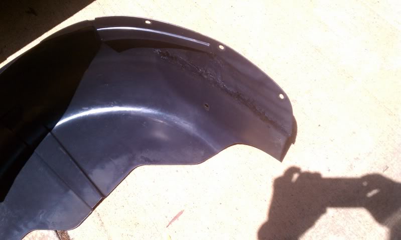

The stock plastic inner fender panels need to be cut in the area that is marked in yellow and then "welded" back flat with a plastic welder. (available at Harbor Freight...cheap)

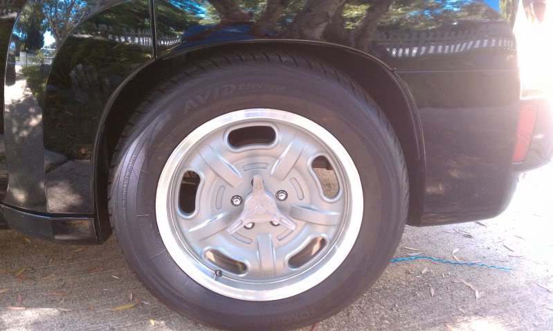

Once it is welded back together it will be flat and look something like this.

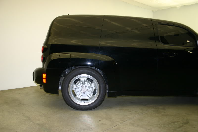

Once you re-assemble everything it will give you more room inside the rear of the fender to mount a much taller rear tire.
The top photo was taken before the plastic wheel wells were re installed.

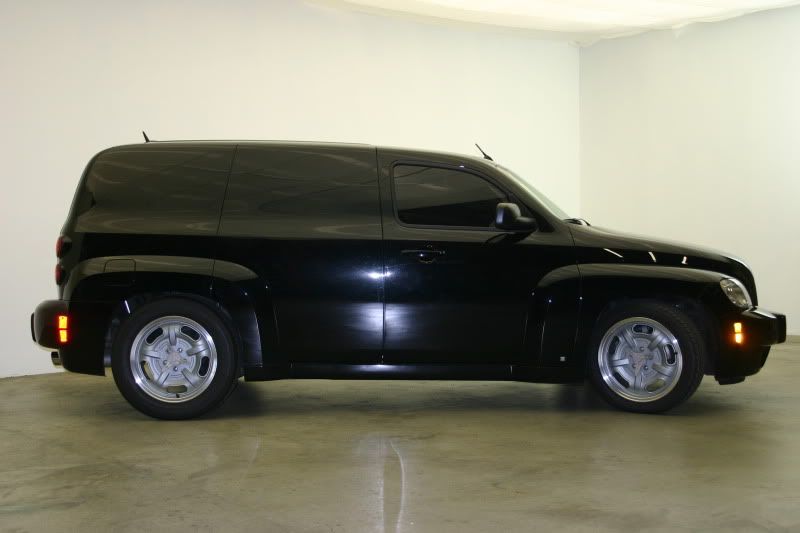

Here is the stance of my panel as it sits today.

Cool...So what size rear tires did you go up to ?
And I notice an extra muffler too ..
Old Jul 29, 2010 | 10:38 AM
lasater's Avatar
Joined: 04-06-2010
Posts: 655
From: Riverside, California
My rear tires are 225/60/17 and the front are 235/45/17. Quite a large difference. And yes it has dual exhaust.
