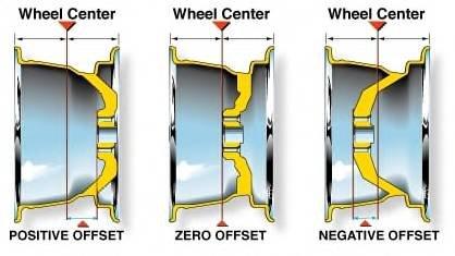

42mmm is the HHR and Cobalts stock offset (not sure if that includes SS HHR ?)
solman98-

Ok, sorry for the confusion. They are stock factory polished alloy and yes they are 17 x 6.5 but with my tire size (215/50) i can go 6.5 to 7.5.
If the backspacing is 42MM, is there no room to wiggle? To say to a 40 offset?

The SS uses a 38mm offset on an 18x7.5" wheel, if I remember correctly.

Our rims have Positive Offset, otherwise they would stick out the fenders.

So after countless phone calls I finally got my wheels!!!! Just so you know, on my 2007 LT2 I went with 17x7, 5/110 bolt pattern with a +40MM back spacing. Everything is perfect. Once its done being gross in good ol Ohio I will post some pics.
