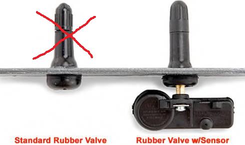

I like the tire sensors and have never messed with them in the past so no idea how much hassle it would be to keep them with the Catera's if I go that route.
You can re-use your stock tpms (tire) sensors, you would only need 4 new correct rubber valve stems, the sensors just slide on the valve stem & are held on by one screw (per wheel)..
Any auto parts should have them @ $3. per valve stem..
See pics:
