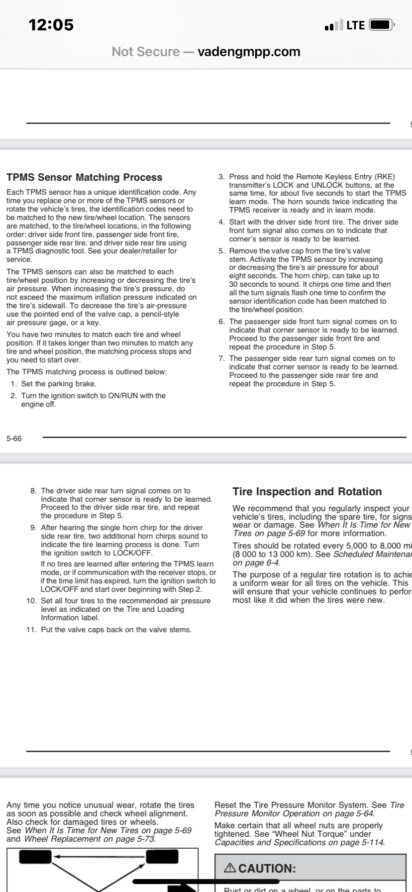

FMG wins, the 2010 model years owners manual states the valve stem pressure system is used to relearn the TPMS sensors

I’ll research the TPMS years and see
This is the 2009 TPMS sensors relearn procedure

And from the 2008 OM I post these for future readers looking for the procedure for their year, to save them time
