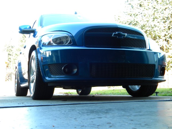

Not sure how much resurrecting old threads is frowned upon here, but this seemed a good place to ask my question rather than starting from scratch. I've got a line on some mint 18" Sky rims just like these. Sooner rather than later, my "new" '06 HHR (2LT, bone stock) is going to need new tires and I was thinking about getting the Sky rims and holding onto them until it's time to replace the tires currently on the HHR.
From what I've read, the factory 17" alloys are 17x6.5 (5x110 bolt circle) with a 42mm offset and 215/50-17 tires, while the Sky rims are 18x8 with a 55mm offset. If I ran a 225/45-18 tire on the Sky rims, should this be a bolt-on application? The calculator I used says that I'll lose about 0.7" of clearance inboard with this combination. I don't want to have to cut anything up, and at the same time I don't want to use spacers and/or longer lugs.

For the Solstice or Sky rims you need to run about a 3/8" spacer since they were designed for RWD applications.

Scroll down toward the bottom and see Mike321's setup. He is running these wheels and pretty sure does not have spacers. You can see how far the wheels are inset...looks kinda wonky if you ask me but to each his own.

That's what I was wondering. The handful of threads I could find here (such as this one) and elsewhere that discussed these rims didn't make it very clear (to me) what, if anything, would be needed to make them work. Opinions were all over the place, and none of them definitive!
I'm assuming a 3/8" spacer is going to require longer wheel studs. One post in the thread I linked to above suggests that spacers are only needed up front. Sound accurate? I really don't want to let myself get into serious modifications of this car (I've fallen into that trap with almost every vehicle I've owned, but I'm determined that this HHR isn't going to go that way -- it's a slippery slope, I know) but changing out the studs on just the front hubs isn't that drastic or difficult.
Thanks for that! I agree that it doesn't look quite right, especially with the minimal fender gap. I suspect my non-lowered HHR would look a bit better. Knowing they can bolt up without spacers, even as a temporary measure, might be enough to get me to pull the trigger on these rims. :)

Anything over a 5mm wheel spacer I believe will need longer studs. If you check over on the cobalt forum (www.cobaltss.net) there are several threads that discuss spacers and the max you can go on our platform vehicles. I'm almost positive 5mm is the largest on stock studs.

Some stated they had clearance issues with the offset and had to run spacers. Some changed the studs, some didn't. I looked into these years ago and the information went so many directions, I just looked for the Cobalt SS wheels since I know it was a direct swap.....

I did change the studs and they were 1.25 a piece at pep boys. I used 15mm spacers, and 255x40 tires, I love them.
