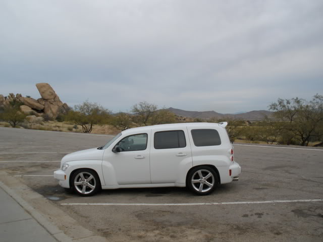

I like that look!
I like that look!
It is almost like De' Ja Vu. Seriously how do you like the ride? Mine was soo much better in every way.
