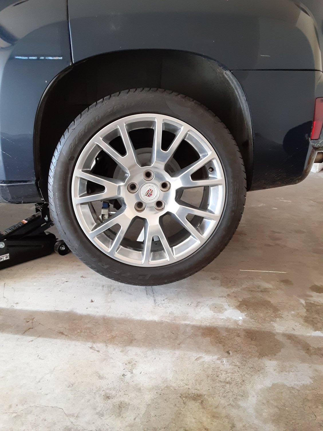

(Jack stands are on struts will sit about an inch higher up I just kinda hung it up there ) 1" seems like it will do the job but a 1/2 spacer may be needed , but then I'd have to worry about rolling fenders most likely .
personally I think these look stellar on this color of hhr, 1" adapters ordered , currently searching for used 225/35/19 possibly 225/40/19 rubber bands for fitting test. I will update in the coming days and I appreciate yalls input.
Now "if" everything works out right , should I keep the caddy logo or change it to chevy hmmm.
I'm all ears on suggestions , cant wait to see finished product myself.
