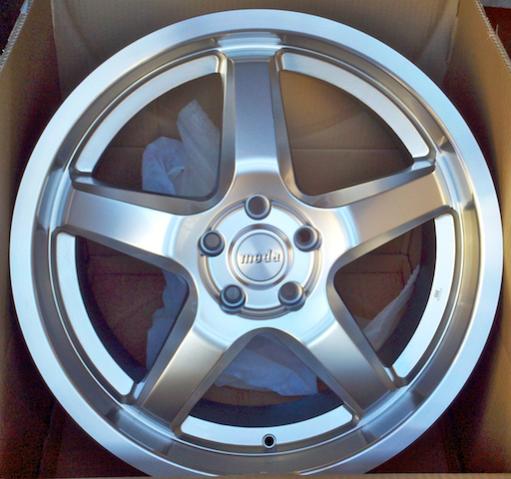

UPS has some new wheels for me today on one of their trucks. I don’t have rubber for them yet, but I'll post up pics later. Then they're going to the powder coaters. Oh yea, I went with a 19x8.5 Moda MD5 with a 55mm offset. Tirerack had them for 39$ a piece. Can anyone who has done the Solstice / Sky wheel swap chime in on how thick of a spacer you used?
Thanks, Mike

Lookie at what Mr. UPS man left me.
