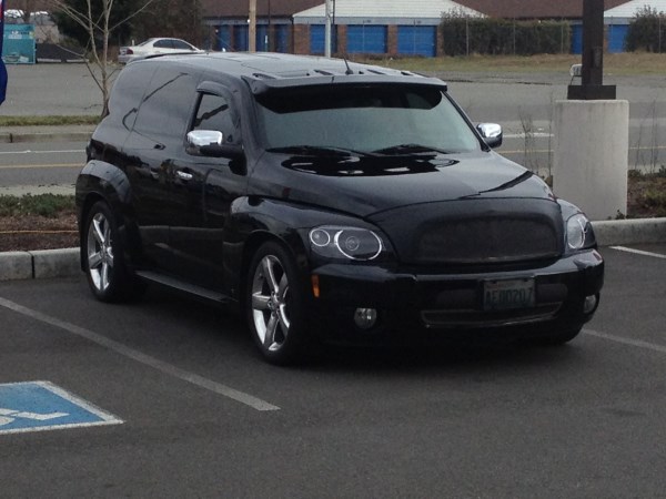

i was just wondering how wide you can go on solstice wheels?

245/45/18 will work on a Solstice rim, but depending on the tire brand you're looking at an O.D. of 26.4-26.8 inches. Anything over 26" risks fouling the inner sidewall on the spring perch on the front struts.

I have 255x40 on mine fit perfect on the panel, but different tires run wider, you have to check them.

Are you guys running spacers with solstice wheels? they are 55mm offset, more than the 42mm hhr wheels.

sorry, yes I am 15mm, with extended studs.
