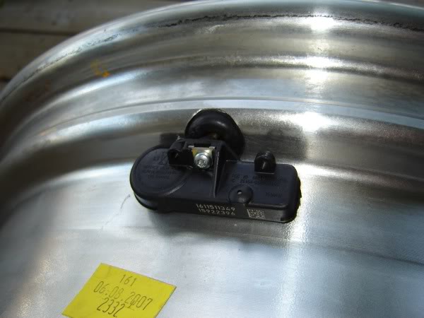

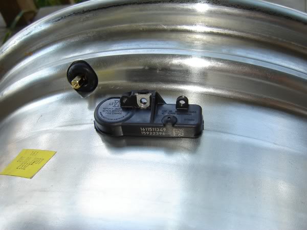

The chance of damaging the sensors is low actually. The valve stems might be able to be reused once, but if they do get damaged they are only about $4 each as apposed to getting new sensors. I'm on my third set of wheels and they're still working fine.
Here's an older post with some info about the valve stems and a couple pictures.
https://www.chevyhhr.net/forums/show...58&postcount=3

Great pictures, helps tremendously. Did more digging on the web and think I've got the gist here. If I just break the first bead on all the tires and remove the sensor (carefully) and reinstall on the new wheels do you think the new set will need rebalancing for the additional weight?
Oh, and low profile tires will be compatible with these sensors - i.e. enough room in there for them?
Are there tires on the new wheels already? I would balance the wheels either way though.
Low profile tires will be fine. As you can see in the pictures, they sit right against the wheel.
