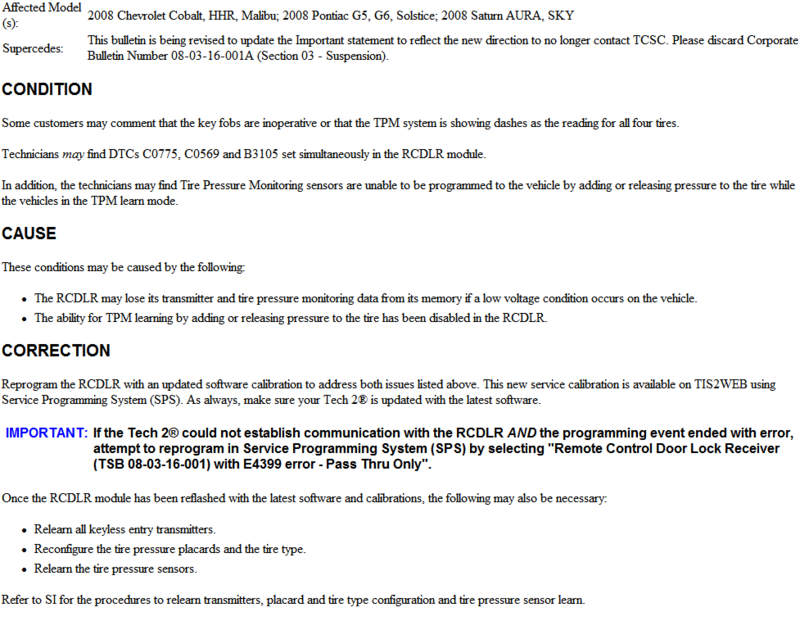

Well, there is this. For some reason you are the fourth in 2 weeks.
Can we assume that the correct procedure was followed to jump start?

we hooked up the cables under the hood on the positive lead and negative on the strut
bolt but it wouldn't start.
We then went straight to the battery and boosted immediately
