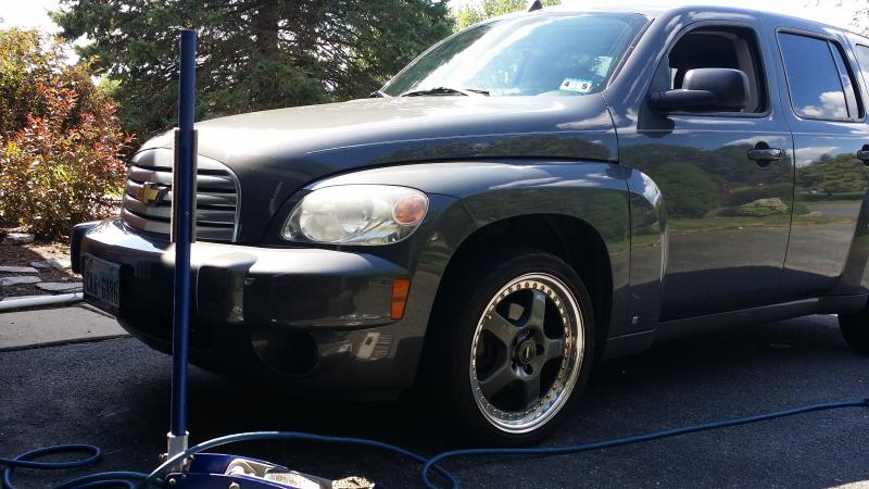

So here's the deal....
We sold my wife's passat, but kept the wheels and some other parts off of it. Until we figure out what we want to do for a vehicle, my parents gave us their 08 hhr ls to use. It's in desperate need of tires... the Texas heat has baked the stockers.
The passat wheels are super nice... 3pc 17x8 or so... Et of around 35... 235/40/17 rubber.
I was actually able to get the front wheel to mostly bolt up... even though the wheels are 5x112 and the hub is 5x110. The hub bore on the wheels is 57.1 (I think that's it) and stopped the wheels from sitting flush.
I'm just trying to figure out what people have done in situations like this... i have no issue getting the backside of the wheel machined out to clear the hhr hub... but
spacers?
Adapters?
Wobble bolts?
Thoughts, comments, suggestions?

OMG!!!! Is that the new wheels shown you have mounted? Take those wheels off right now and put proper sized wheels on. They are 110 as you know, not 112MM. You trying to kill yourself? Sometimes I wonder why I even bother with items like this.
Sorry to vent - but what you are doing is outright dangerous.
Take them off now if you are actually attempting to drive with them on.
No apologies for sounding harsh.

Phew - Man I was worried worried worried that you cinched them up and went riding.
Thanks for getting back and clarifying - man you almost gave an old man a heart attack!!!

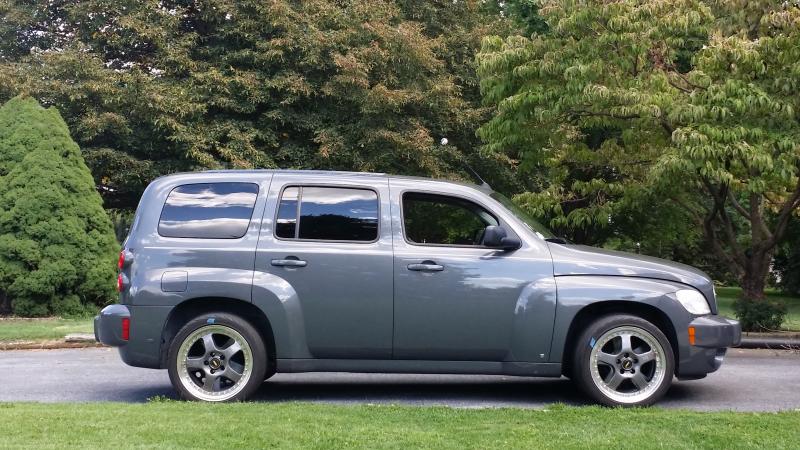

While adapters like the ones linked above will work for the mounting situation, note the thickness of those things. They are 1.25" thick which would put even a factory 42mm offset rim out past the edge of the fenders. Your rims are 35mm offset which is another just over 1/4" wider on top of that.
My suggestion would to be to look around for set of used tires. You should be able to get them installed for similar price as it will cost you for the adapters.
Also those tires are 1" shorter than the factory size HHR tires and will throw the speedo off a decent amount if that is any concern to you.

Those wheels are nice and all but unless you plan to do a hub swap there's no way to make those things work unless you plan to put a set of fender flares on to compensate for the extreme poke you'll have running adapters.
