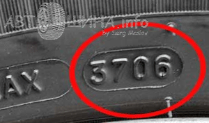

How do you know the date of manufacture tires?
As recommended U.S. Department of Transportation (DOT - Department Of Transportation - the organization, including, certifies bus for sale in the U.S. market), the date of production of tires is applied to the lateral surface of the tires required, with a clearly defined form. Since the year 2000 - a four-digit number in an oval, the first two digits indicate the week number of year and the last two digits - year of production. That is, for example, encoding 3706 (as shown above) on the sidewall of the tire means the tire is made at the 37th week of 2006. This rule applies to all tires of all producers who orient their products including the U.S. market (DOT certification for the American market required). In fact all the leading tire manufacturers follow this rule, regardless of geographical distribution of tires.
Until 2000, the date of manufacture on the tires designated three-digit code (first two digits - the number of weeks, the last - the code of year).
Manufacturers usually do not give guarantees for the preservation of operational properties of the tire after 5 years of storage, even if it complied with all requirements
