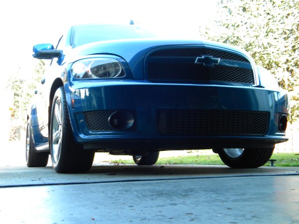

Wow, those are all good questions that I have pondered myself. The offset for hhr is 40, so if you pick a wheel with a higher offset, say, 55 thats what I picked, you need a 15mm spacer, with extended studs in my case, some have done this with with out them. I think without coilovers the height limit is 26.1 there are lots of tire sizes that will get you there, I picked 255x40x18, cause i like the fat tire look. The offset sizes you sugested I think will look good. I have an extra set of these wheels I am planning on putting some 265x40x18 on them, but I'm not sure they wont rub in the rear well, the 255's have about 3/8" clearance. Have had lots of different tires on the HHR, have learned they are all a little different sized from each other, Like the Michelin Pilot sport, 235x45x18 fits sweet with a 7.5 wheel, so your best bet is to try one on.
