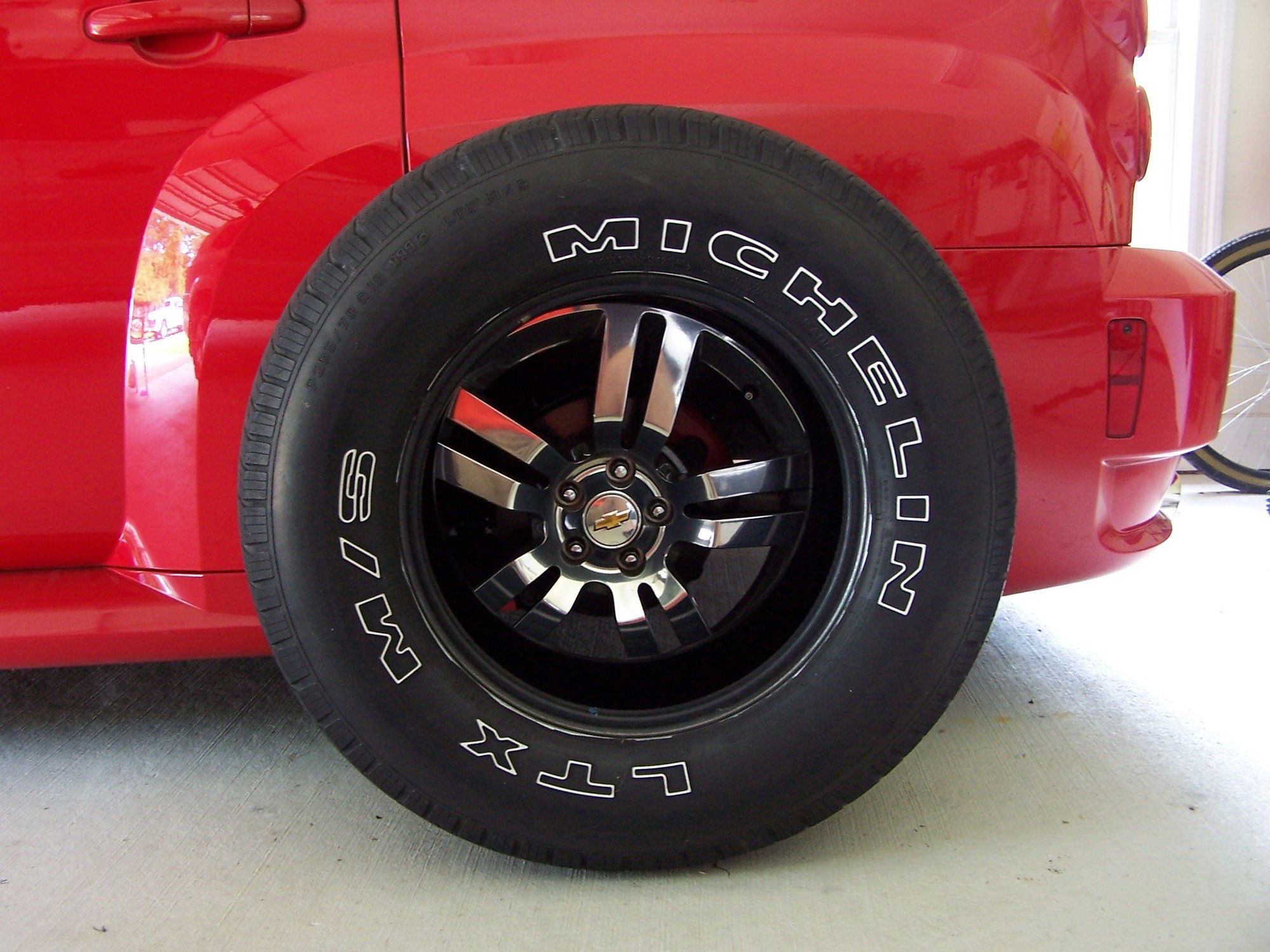

265/70/16 tires are like pickup truck tires. That's the size on my full size Dodge Ram truck. Waaaay too tall for the HHR.
They are about 30.5 inches tall. Max size on the HHR is 26.3 inches tall.

They say "A picture is worth a thousand words"
Here's one of my old Dodge truck tires, 265/70/16, leaning up against my HHR tire.
