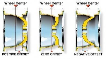

Maybe this visual showing offset will help... & generally factory alloy rims are forged (stronger & lighter)......... In aftermarket many are gravity cast.
Your one step ahead of me, was going to do the same thing.

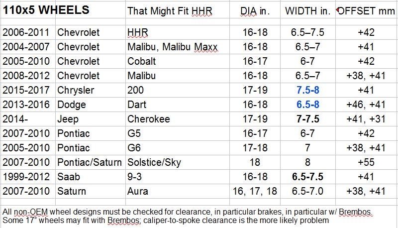

  #69
PulpFriction's Avatar
Joined: 12-05-2014
Posts: 3,330
From: Northern Ohio
With full knowledge that this thread is ancient, here’s a chart I made for myself. Use at your own risk. Maybe someone knows if any of them have an issue with center bore diameter. I don’t like the Solstice/Sky option because the offset requires either spacers or adaptors, both inelegant in this case, but included it because they’re so often mentioned.

geg's Avatar
geg
Joined: 03-22-2010
Posts: 2,108
From: Russia Ekaterinburg
The center hole of the 18-inch Pontiac Solstice wheel matches the HHR.
I would add some European car models to the table, but most likely it will not be useful for the North American audience.
