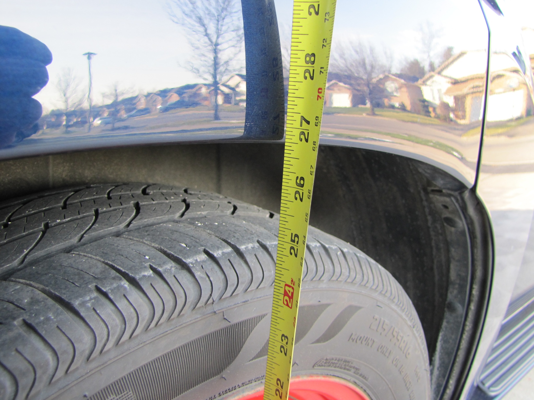

Old Mar 13, 2017 | 02:09 PM
jeffs396's Avatar
Joined: 07-12-2006
Posts: 1,703
From: NE Ohio
Old Mar 13, 2017 | 02:14 PM
Posts: 39,988
Nice, 20's!
Hmm I need taller tires, my 215/55R16's don't measure up!
Attached Thumbnails Wheels and tires-20007-hhr-replacement-lower-springs-001.jpg
