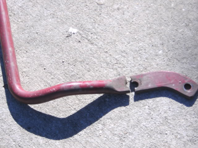

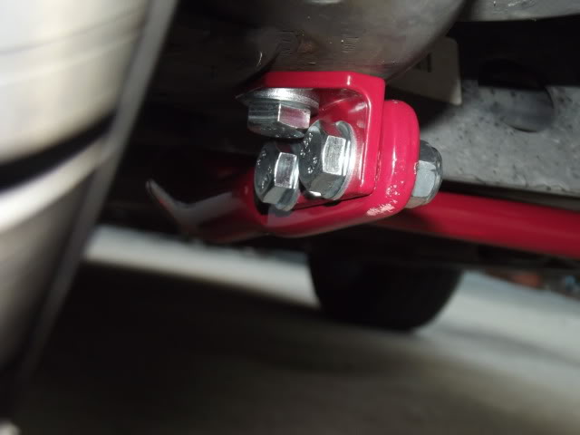

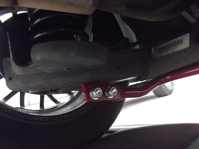

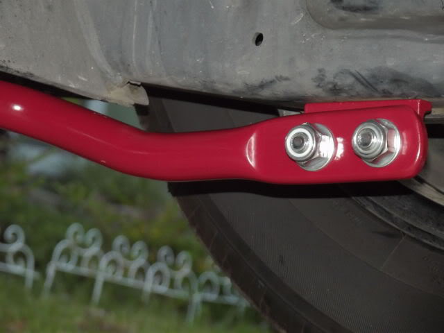

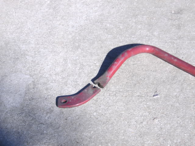

I broke two of the older design Eibach sway bars before I put the new design on.Eibach was very good at standing behind their product and sending me new ones at no cost to me.I got one of the 1st of the new design when they released it and have not had any problems with it.Seems the old design had a weakness where it would break at the mounting points.

Awesome thanks for the info and pics nole. I actually can see how the curves design could put more stress at the forward bolt hole, especially with our torsion bar rear. I have used eibach before and considered them a top teir suspension manufacturer, so I'm glad to hear they straightened things out. Btw nice hhr and I actually grew up around lake city Florida, a bit north of gainesville. :-)
