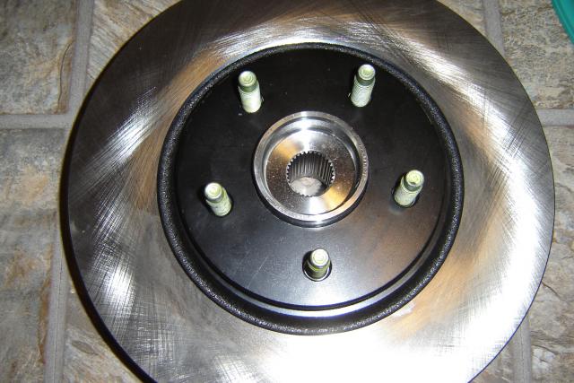

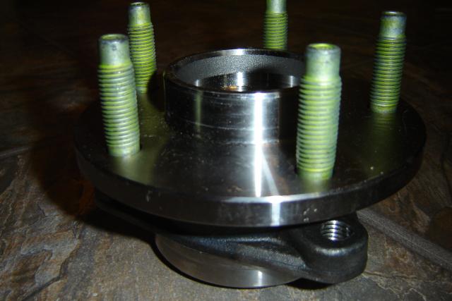

pic 1 I measured a set of spare Timken bearing hubs I have, they are 65.1 mm where the wheel sits and 67.1 mm where the brake rotor sits so the rotors are hub centric and in the last picture the rims are now also hub centric

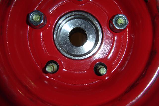

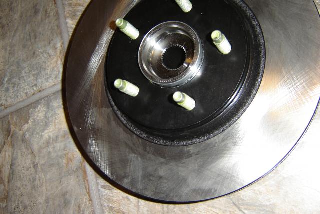

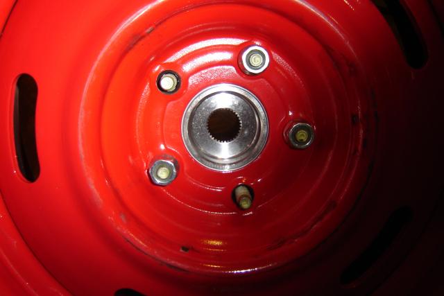

As I stated , these worked for me in the past and these rings work for me now, I don't believe the stud holes are off center. I do see that the hub is off center in the 3 rd picture from the top and the hub is centered in the last picture with the rings.

I inspected the bolt holes in the wheel they are not elongated but are a little larger than the stock 18 hole steelies, as you can see in the third and fifth pictures from the top.
