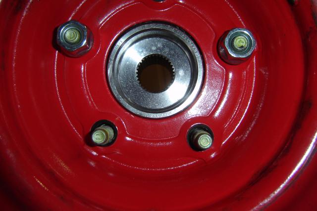

Posts: 40,083
Notice the space around the hub is not even, or centric

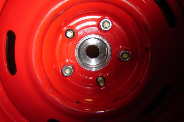

with hub rings, the wheel is centered on the hub. This resolved my issue, not more shake, on the stock steelies or the Wheel Vintiques Rally Rims.
