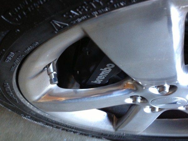

Since your wheel is 7.5, I can tell you that a Michelin pilot sport as fits in the 235x45x18 size, I would have bet that it wouldn't, but it did, 08banshee put a set on his SS, He loves them.

stock SS wheels. these are 55 offset

Aren't you running 15mm spacers with those? Atleast I thought I saw you state that in another thread. With those you are right back at the stock 40mm offset lol.
Old Nov 1, 2012 | 10:57 PM
Yep, just took a little math, and a few bucks.
I think it was dumb luck the wheel clears the Brembos.
