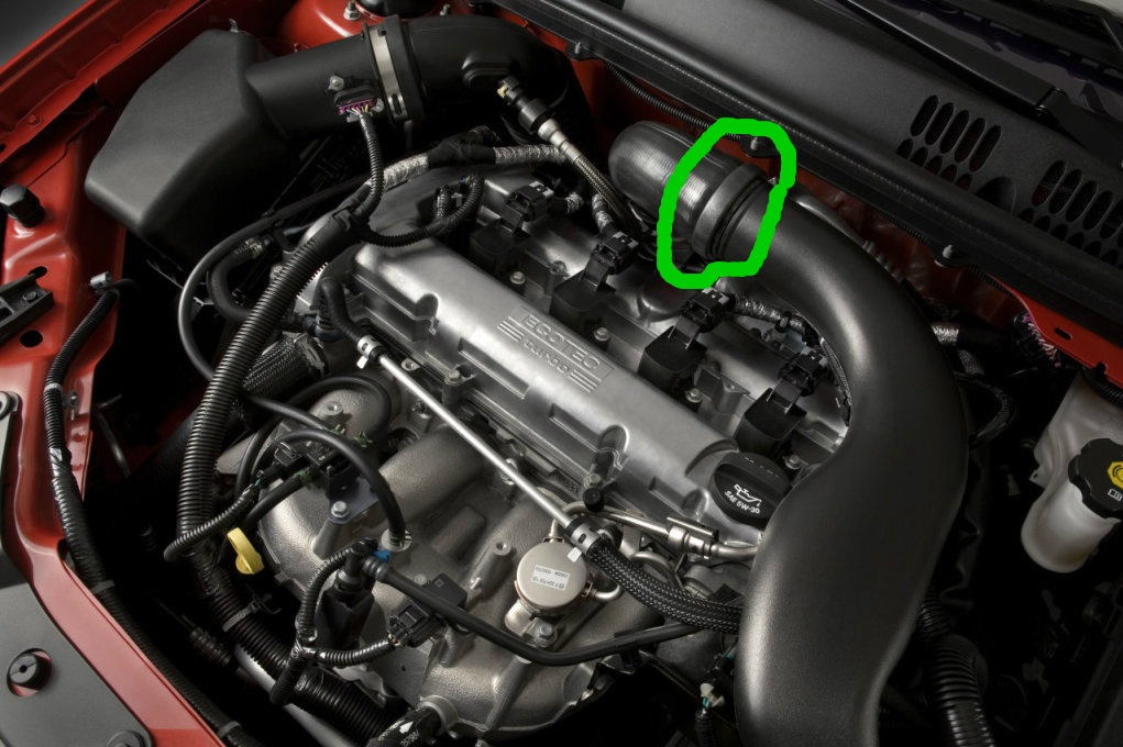

Ahhhh! will someone answer my question on how to get the stock coupler clamps off???. lol do I cut them, or pound them off? ive never seen this style before and I dont wanna break them just incase i have to put the stock hot side back on.

Mine were tight too, worked a small screwdriver in there to break them loose, the cold side was harder than the hot side, I didn't have to cut anything, maybe a little wd40 in there will help.

I'm confused. Why are you trying to separate the rubber from the plastic?

Im not getting the upgraded couplers, my buddies on stock couplers with no problems and he's at 24psi with zzp's hot side. I was considering the cold side to but no point if the stock one works fine. Im not going for crazy power anyway, my goal is 280-300whp and 320-340wtq so the stock cold side will be fine.. Idk what this auto transmission is capable of either, thats something else that im concerned with.
I wanted to take this piece off without breaking it, Everything ive read stated to cut them off.

You can buy a Spectre brand coupler at most auto parts stores for cheap

Ic. I would not reuse those as they prone to leaking from the factory. Just cut them off with a dremel and use t-bolt clamps instead. BTW, the auto tranny is capable of 500 hp based of what I have read in these forums.

Wow really...That changes everything. lol With full bolts/tune I dont think im capable over 315hp/340wtq.

Yea i think im just gonna do that, much easier. Thanks for the help.
